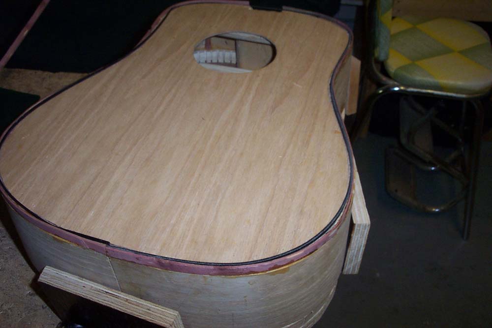

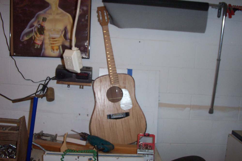

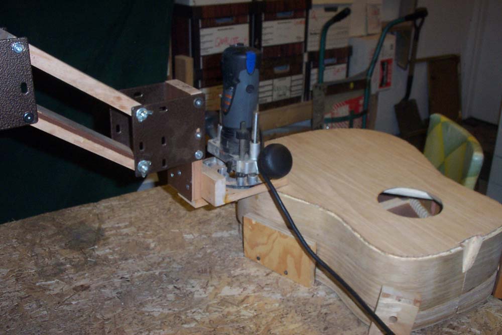

Hi guys, thought i'd show you a couple of pics of my first try and jigs. Happy nEW YEAR TO ALL OLF'ERS !
My guitar is finished now but i ran out of batteries for our digital camera, i'll post more pics soon !

Hey Serge,
What kind of wood is that? It looks like oak.
Interesting.
PostPosted: Sat Dec 31, 2005 4:11 am
Posts: 8553
Purple heart bindings?
Get them batteries charged up! We wanna see the finished product!
PostPosted: Sat Dec 31, 2005 4:34 am
Posts: 688
Fantastic job! Can't wait to see more of this one. By the way, it looks like you didn't do an end wedge. Usually this is done before binding, so will you do some sort of inlay? Anyway keep up the good work, and nice binding jig too!
PostPosted: Sat Dec 31, 2005 6:53 am
Hi bruce, your right it's oak ply for top and back and cedar ply for sides.
Hi Lance, your wrong, it looks like purple heart but it's aromatized red cedar bindings with some sort of black plastic purf that i had to remove cause i didn't have the right technique to install it . Gotcha!
Hi Mr tl507362, thanks for your kind words, i did put a wedge afterwards and it was a pain in the @#$%^&, i'm saving the rest for later so you guys can have a good laugh or a reminder of how it can go so wrong .
Thanks everyone!

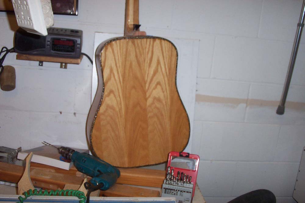

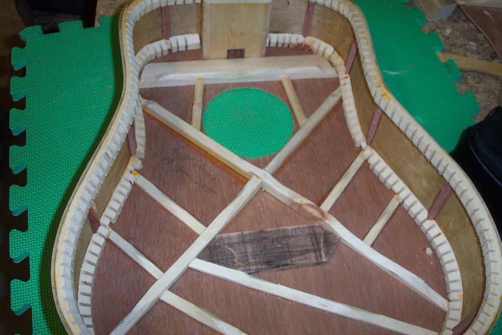

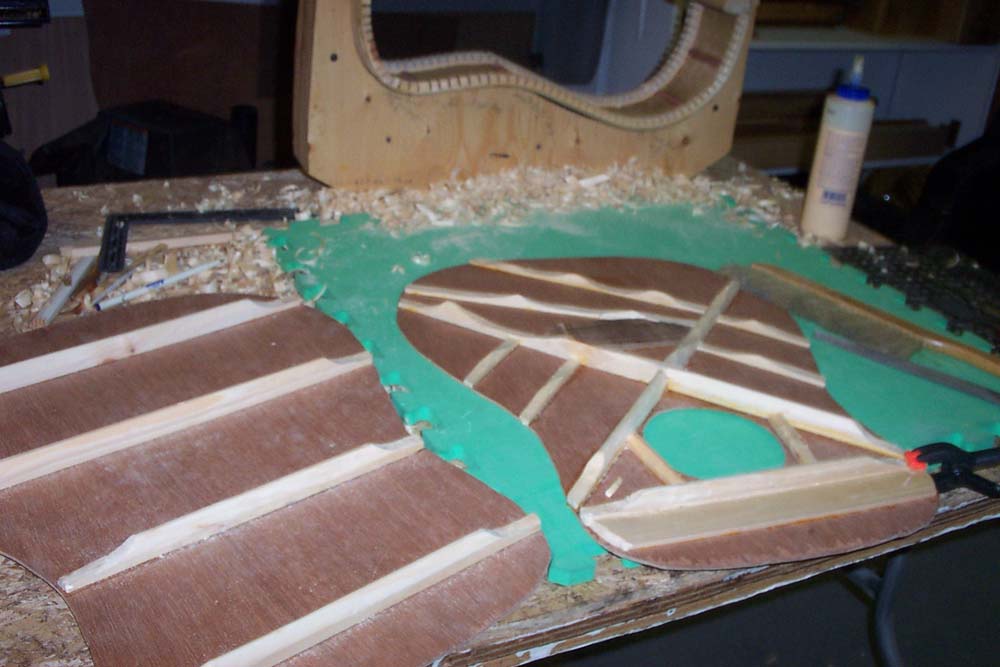

here's a couple more pics.
PostPosted: Sat Dec 31, 2005 9:20 am
Very impressive. I'm going to try building one in 2006...hope mine turns out half this good.

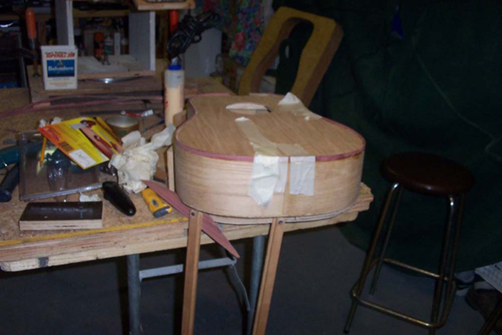

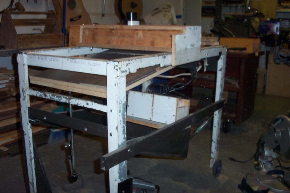

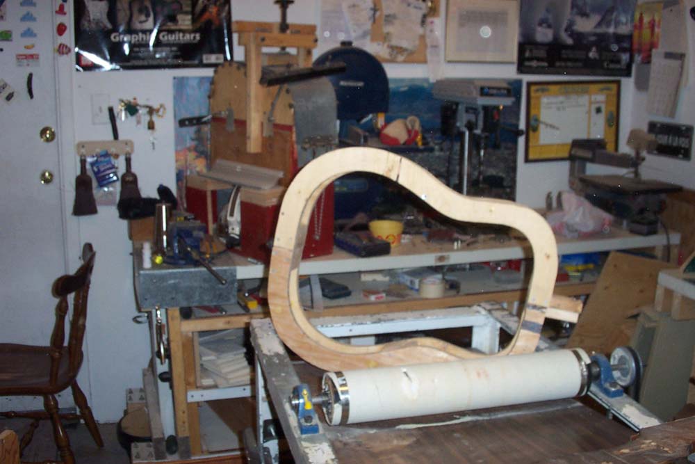

Thanks Bill, here are a few more shots
her it is, my BABY!
The plastic purfling had to be removed so i found some kind os shiny beads that i inserted with epoxy instead.
As you can see, my neck is a little offset!
My attempt at building a bandsaw, amazing what you can do with pillow block bearings!

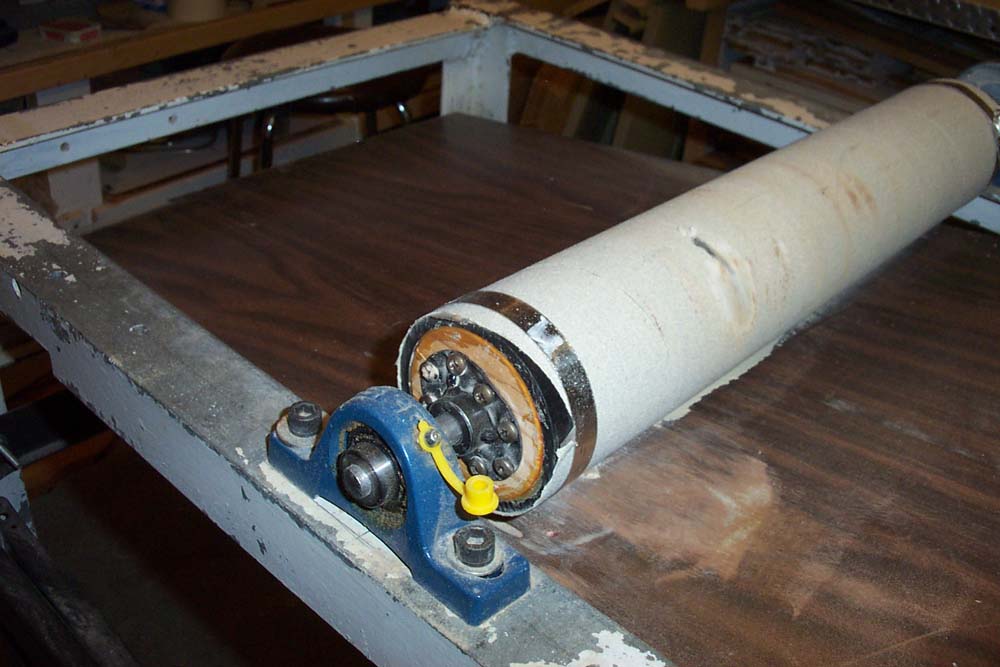

My faithful drum sander, really proud of that one!

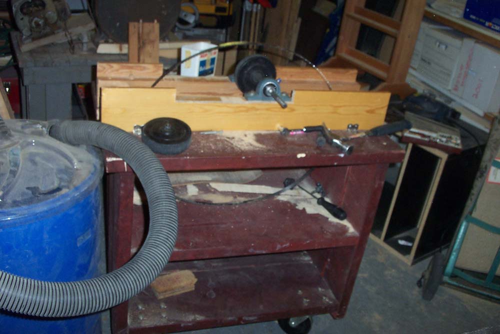

And finally my side bending jig and my second mould for guitar no 2. Yes that's a kettle that you see in my side bending jig!

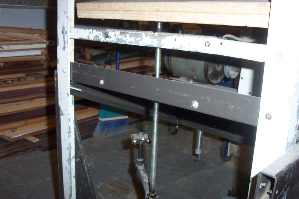

A couple more pics !
A threaded rod to raise or lower the table that is swingin' on a cross bar at the higher end.

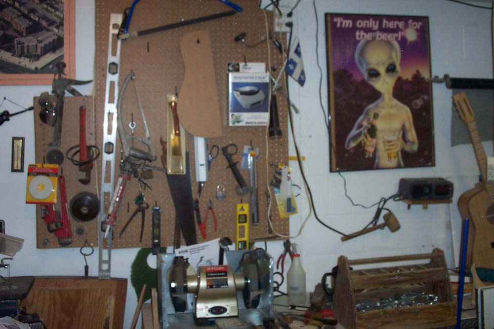

my humble shop.
What a mess!, can't wait to be more organized!

BTW, don't worry, my kettle was a good idea for bending plywood and inexpensive but i'll follow Mario's advice for hardwoods and build a second bending machine using 3-200 watts each lightbulbs unless somebody here would have a spare heating blanket to sell to a newbie for a fair price!
